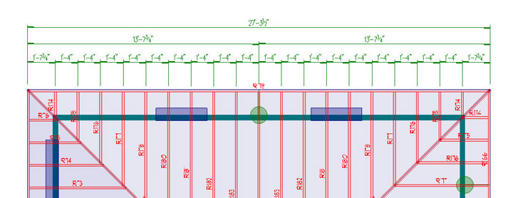

Roof Framing Can Be
Labeled |
When stick frame construction is
created for the Roof plan, ‘Framing ID’ can be turned on as a Visible
Item. This will display a label for each framing member. With this
information a Roof Framing Schedule can be generated. All framing
members will be indicated by an R followed by a number. If framing
members have the same size, then they will have the same ID
label.

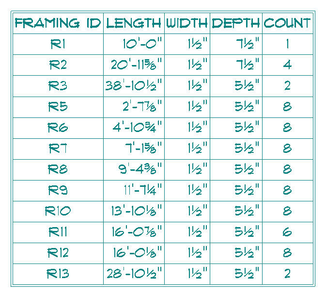

Schedules of Roof Framing Can Be
Created |
created for the Roof plan ‘Framing ID’ can be turned on as a Visible
information, the Roof Framing Schedule can be generated. It is an
option found under the Notes menu for Framing Schedules. The Framing
schedule gives the label, dimension information, and count for each
size.
