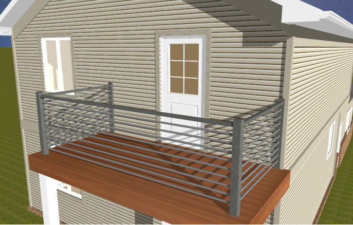

Horizontal Spindle Option
Version 13 now has the ability to
change the orientation of railing spindles to horizontal. This is
useful where the railings need to be modeled to show cable railings. A
Spindle profile is selected to change the appearance of the spindles
for the 3D model.

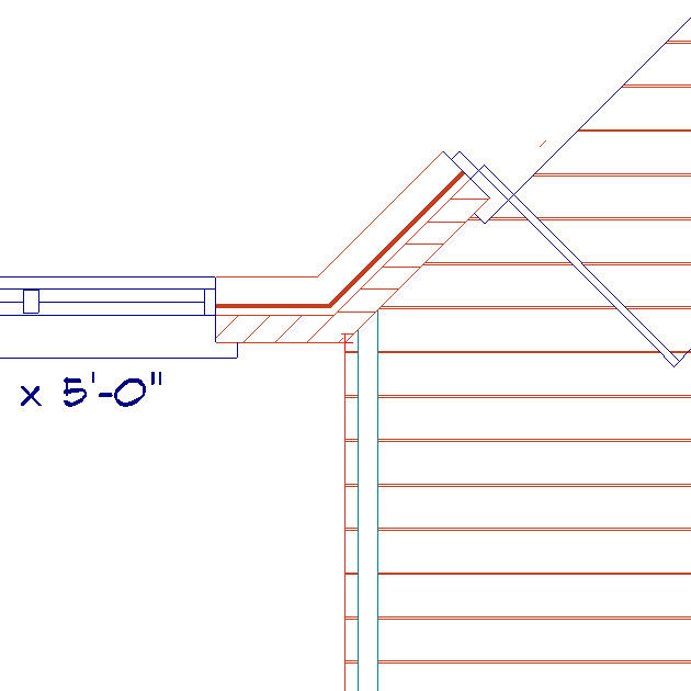

Mitre with Wall End Style
Where a railing meets a wall at an
angle, the option for the Railing Post Style can be modified to ‘Mitre
to Wall’. This will cut the corresponding railing end on the same
angle to abut the wall properly.

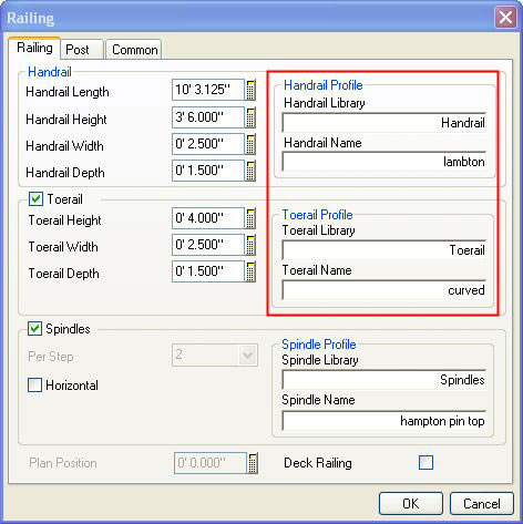

Profile Tool Used to Define Handrail and
Toerail Shape |
The Lathe Template is used to
create custom shapes for the Handrail and Toerail for railings. The
Lathe allows you to “convert” custom profiles out of square stock that
will be used on the 3D model and the generated working drawings. Once
a profile is added to the Lathe library it can be applied to the
railing. SoftPlan also provides pre-made profiles that can be selected
to use for the Handrail and Toerail.
