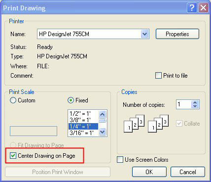

  Center Drawing on Page Option Added
The Center Drawing on Page option has been added to the Print menu. This saves having to Position the Print window around an entire drawing prior to printing.
