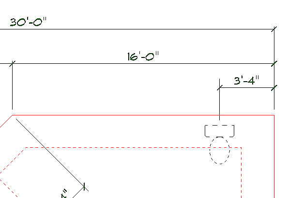

  Dimension and Extensions Can Be Added and Edited to Floor Framing and Slabs
Dimensions and Extensions can be added and edited in Floor System mode making it easy to modify aspects of the floor system, such as the spacing of individual framing, framed holes, slabs, beams, etc. These commands help to create a more accurate Floor System plan.

  Plumbing Drops Available to Extension and Dimension
Plumbing drops belonging to plumbing symbols now have the ability to extension and dimension. This allows for more accurate placement of floor framing in relation to plumbing symbols.
