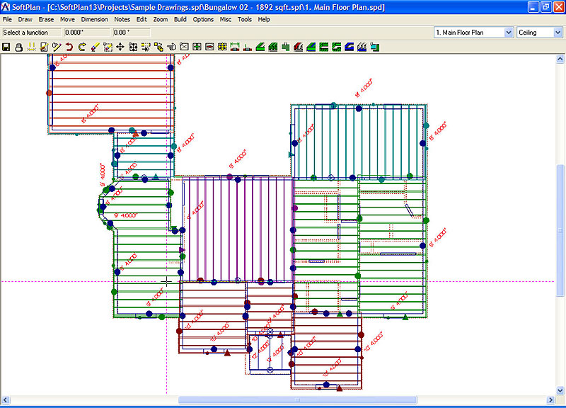

Area is Reported on a Ceiling
Edit |
Simply Edit the Ceiling drawn in
Ceiling mode to display the area. This is useful in determining Heat
Loss and Gain values, as well as, materials.

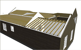

Plate Command
When a Plate material has been
added to draw from Ceiling Mode, it will be especially useful in
construction where Roof rafters will bear on additional plates placed
on top of the Ceiling Joists instead of the top plate of a wall. Once
the Ceiling Joists and Plates are drawn, the Plate will automatically
set above the Joists and set the correct level for the Roof to be
drawn and reference.
Plate Height Added to Visible
Items |
The Plate Height information for
the plan can now be displayed in Ceiling mode. This is selected under
the Visible Items menu while in Ceiling mode.

Reference Points Can Be Adjusted
off the Ceiling |
Reference points of Ceiling
materials can be adjusted off the ceiling. This is useful if a wall is
moved in the plan and the ceiling must be adjusted to reference the
new wall location. It can also serve if a new wall is drawn and the
reference point for the ceiling must be adjusted to it.
Reflected Ceilings Plans Can Be
Created Using the New Display Tile Option |
When laying out suspended
ceilings, the “Display Tile” option will allow the grid to be
displayed in Ceiling mode. Reflected Ceiling plans can be developed
using the grid.
Sloped Ceiling Joists Added to
Automatically Follow the Pitch of the Ceiling |
This is an automatic feature where
Ceiling Joists will not be horizontal. Once the Ceiling is drawn with
the proper pitch information, the Ceiling Joists will follow and slope
with the Ceiling.
