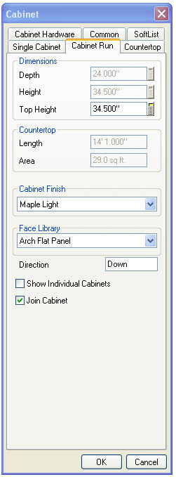

Auto Cabinet will allow all of the
cabinets in a run to be placed by simply tracing the location with a
single line in the plan. The upper and lower cabinets can be added at
the same time with the selected style and finish. Items such as
dishwashers that have been placed in the room are automatically
incorporated into the cabinet run. Also openings and opening trim,
depending on height and offset, are automatically added as
well.

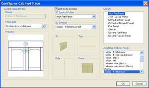

.DXF Symbols Can Be Linked to
Cabinet Faces |
Cabinet Faces can be generated in
3D models with a more realistic, dimensional .DXF symbol. This symbol
is used to represent the front face of the Cabinet and can include
more life-like indentations of panels and rails. The option for “Link
to 3D Symbol” is set within the System Library in editing the
individual Cabinet Face. Many different styles and libraries of .DXF
symbols are provided. They are applied in generating the actual model
for Cabinets.

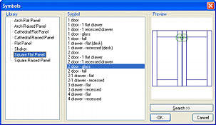

Face Libraries Allow the Style of
All the Cabinets in a Run to Be Changed At Once (ex: Cathedral to
Shaker) |
With a simple edit of a Cabinet
run, the Cabinet face style can be changed for the entire run of
cabinets. This saves valuable time in having to change the style for
each individual cabinet if the customer should decide on a different
preference.
Finish Options Allow the Finish
of All the Cabinets in a Run to Be Changed At Once (ex: Cherry to
Oak) |
run, the Cabinet Finish can be changed for the entire run of cabinets.
This saves valuable time in having to change the finish for each
individual cabinet if the customer should change their
preference.

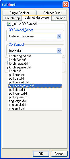

Hardware Can Be Added to
Cabinets |
Cabinet Hardware Points have been added
to the Cabinet Faces. These are shown in the Cabinet Face Previews. The
points are linked to a .DXF 3D symbol for Cabinet Hardware. These will
display in Interior Elevations and 3D when the Cabinet Hardware is set to
extract. |

Styles Added: Arch Flat, Arch
Raised, Cathedral Flat, Cathedral Raised, Shaker, Flat, Square Flat, Square
Raised |
These new Cabinet styles are
straightforward to select as a Cabinet Face when drawing cabinets.
Even later in the design stage, the styles can easily be changed to
suit the preference of your customer in one simple Edit of the Cabinet
run.

Top Height Property
The Cabinet menu now includes the
option to set the “Top Height” property. This value gives the Offset
where the top of the cabinet is to be placed. This is useful for
placing the tops of Wall Cabinets in alignment that may have different
heights.
