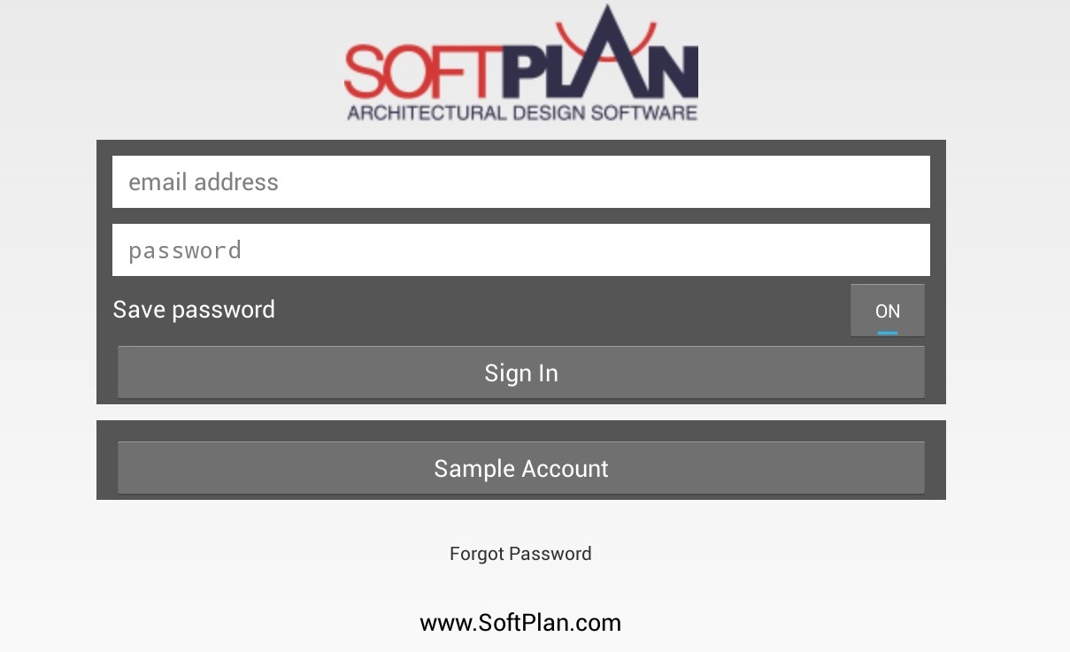

1.    Begin by opening the reView app. You are prompted to enter your SoftPlan+ login information with an option to save your password. When you are done entering your email and password, tap Sign In.

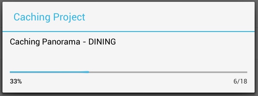

       A project can be downloaded to the device to create an offline backup that can be accessed locally. This allows you to view your projects without a data connection.
                       i.            To do this, press the Manage Offline Content button in the top right corner of the SoftPlan Projects screen.
                     ii.            Next, locate the project you want to download and tap it. The project begins caching.
When you're finished caching projects, select Done.
                   iii.            Once a project is downloaded, it can be accessed offline. An indicator under the project name provides the date on which the project was downloaded.
