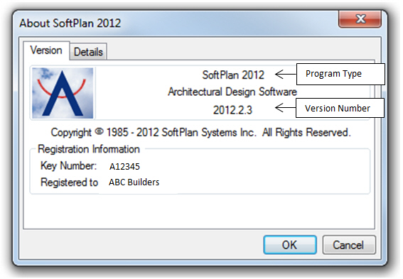

Find the following information in the About SoftPlan dialog. To access this dialog, select Help > About SoftPlan.
1. Determine your current SoftPlan version.
2. Determine the appropriate patch version. Each SoftPlan patch only updates to the next consecutive version. For example, if you have version 2012.0.0 and the most current release of SoftPlan is version 2012.0.2, you must first apply the version 2012.0.1 patch then the version 2012.0.2 patch can then be applied.
3. Determine your SoftPlan program type. SoftPlan Lite patches cannot be applied to a SoftPlan program, and vice versa.

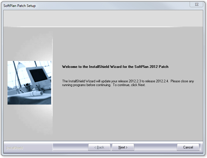

2. The Welcome dialog is shown.
Patch Welcome

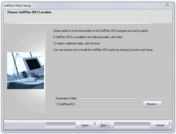

3. Follow the on screen instructions until you reach the Choose Location dialog.
SoftPlan Patch Location
If the folder shown is not the folder you wish to patch, select Browse to locate the appropriate folder.
Select Next.
