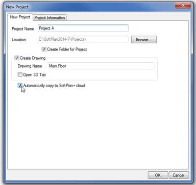

  1. To begin, select File  ® New  ® New Project. The New Project menu opens:
  1. After specifying the project’s name and location, and the drawing information, place a check in the box next to Automatically copy to SoftPlan+ cloud. Your work will now be copied to the cloud drive automatically each time the project is closed.
  2. Select OK to save your changes.

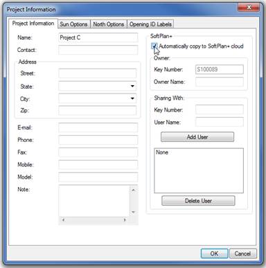

  1. Within the project, select Model ® Project Information. The Project Information menu opens:
  1. In the SoftPlan+ section of the menu, place a check in the box next to Automatically copy to SoftPlan+ cloud. Your work will now be copied to the cloud drive automatically each time the project is closed.
  1. Select OK to save your changes.

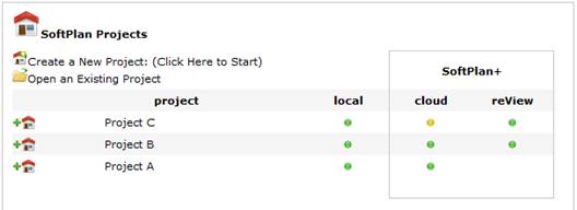

When SoftPlan 2014 is opened, the start page contains a scrollable list of your projects with columns to indicate the local and online availability of each project. A third column indicates if the project has been published to the cloud for SoftPlan reView.
Illustration 1
For the local and cloud columns, a green dot indicates that the project is available. A yellow dot indicates that the project is available but that it is an older copy than its local or cloud counterpart.
For example, in the above illustration, the local version of Project C has information that has not been copied to the cloud, so a yellow dot notifies the user that the cloud contains an older save of the project.
Finally, if a project has been published to the SoftPlan+ cloud to be opened in SoftPlan reView, a green dot appears in the reView column.

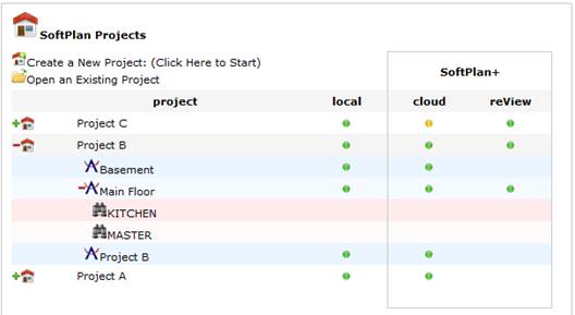

Projects can also be expanded to view if individual components of the project are available locally, in the cloud, or for reView.
To do this, place the cursor on the green plus icon that corresponds to the desired project and click to view a list of drawings. Drawings can be further expanded to view 3D panoramas that have been created from specific rooms within the drawing (see Illustration 2). Click the icon again to collapse the list of drawings or panoramas.
Illustration 2

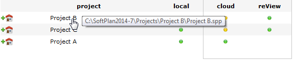

Additionally, you can hover the mouse over a project name to see that project’s location (see Illustration 3):
Illustration 3

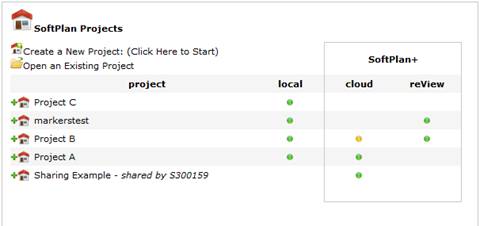

When another SoftPlan key has shared a project with your key, the next time you start SoftPlan, the shared project will appear in your project list.
Illustration 5
Noted beside the project’s name is the key number that shared the project, or the “owner.” From the start page, a shared project can be downloaded from the SoftPlan+ cloud to be saved and edited locally.
To do this, click on the shared project’s name to open it. SoftPlan will download the project from the cloud to your local system and open it. Any modifications that you make to the project will be uploaded when you close the project.

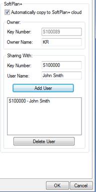

Sharing a Project
You can share your projects with other keys using the SoftPlan+ cloud. With the project open, select Model ® Project Information. To the right of the menu is section for sharing:
Illustration 6
Owner
Key Number
This is the key number that is considered the “owner” of the project. When you share your project with another key, this number appears with the project to indicate ownership.
Owner Name
Use this box to include the owner’s name along with the SoftPlan key number.
Sharing With:
Key Number
Use this box to enter the key number with which you want to share your project.
User Name
This option allows you to associate a name with the key number you are sharing with. This name is used to inform you of the user or users who already have the shared project opened.
Add User
Once the pertinent information has been entered, press this button to add the user to the sharing list located under the Add User button. Multiple users can be added to the sharing list.
Delete User
Use this button to delete a user from the sharing list. To delete a user from the list, click to highlight the user’s key number and/or user name and press the Delete User button.
Note: A project can only be shared by the owner.
Select OK when you are finished.
