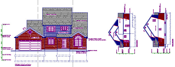

Multi Drawing Outline
Drawing inside a Multi display their limits as dashed lines making it easier to arrange the drawings.
