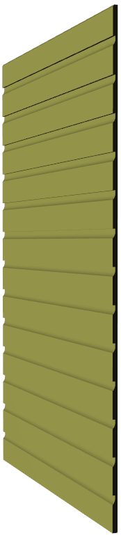

Dutch Lap Siding profile added

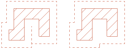

Footings
Explode a footing, in plan view, and the lines can be fine tuned.

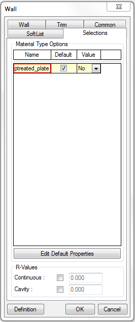

Pressure Treated Bottom Plate selection added to Walls
Selecting this option allow the materials list to count Pressure Treated wood without having to have a completely separate wall definition.

R-Values added
R-Values (continuous and cavity) are stored with each wall and are used when performing energy calculations.
